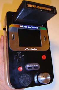

Atari 2600 Portable, Hand-built
Chapter 16 of the book
Build a portable Atari 2600 system with a 3" TFT display, built-in battery pack, new-style joypad and paddle controller.
This project can be constructed by hand using printed templates and hobby materials. You'll also need a soldering iron, X-Acto knife, wire, screwdrivers and other common tools. Please note this is the most complex and time consuming project in the book.
