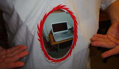

It dawned on me that making a see-through Portal shirt might be a huge success. It’s probably the geekiest Halloween costume you could possibly make. You see, I do what I must, because I can.
The system consists of a front-mounted LCD, pocket-mounted battery pack and rear-mounted camera. And the best part is you can watch us build it on Episode 4 of the Ben Heck Show, since it is out of beta and releasing on time.

Tip for anyone building one of these: Try and get a camera with a wide-angle lens. I think it might make it look more “real.”
Actually Kyosho, a narrower field of view would have been better. It would have kept objects closer to actual size. The screen being small is part of the equation too.

The screen stands out under the shirt a bit too much. Maybe using some foam around the screen to make it an oval and then padding it all with another layer of foam all over the front side of the shirt would take care of that problem. Anyway, how does the back look? There must be smaller webcam type cameras out there that won’t protrude so much (if you don’t care about the image quality), and if you sit back on a chair won’t go into your spine. Great stuff, though a bit early for the technology. Rollable screens and totally flat cameras are a bit out of the DIY tinker’s price-range I suppose.
I built something similar using two 7″ lcd’s and two pin hole cameras. I drilled out the center of the buttons on a button up shirt and mounted the pinhole camera behind it. Same for the back (had to add a button). Protected the lcd via some plastic binder inserts, added blood, and walla gun shot wound Halloween costume. Won 1st place in a local costume contest. No crazy modding, everything ran off 12Volts so I just grabbed two 12 volt lead acid batteries and stuffed them in my pockets. Ran the camera facing the rear to the front lcd and vice versa.
